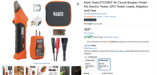

I recently bought a house that was built in 1975 and a few changes have been done since. I have a 3 way switch that does not appear to do anything, with no matching 3 way switch that I can find. There is power to the switch. I also have several outlet boxes with blank covers on them. Some have cable wires in them, some have Telco wires in them some have power wires in them. Some of the power wires are hot, some are not. I am trying to sort it all out so I at least know what is what and where it goes. I suspect some of the outlets with blank covers were for thermostats for the electric baseboard heaters that have been removed. I saw an article that recommended this:
I was wondering if there was something better/cheaper that would do the job.
TIA- Jim

You could try this for a cheaper option. It includes adapters for lights, sockets and bare wires.
You'll have to do some mapping but start at the switch and find the correct breaker--check the labels at breaker. etc..
I wouldn't worry about phone lines or coax unless you need them and those should be fairly obvious to sort out.

If you want a tool for it and especially for home use you can buy circuit tracers like that for under $50. Referring to the $200 one, not Klein.
I'd do it the old way of either using a volt meter or attaching a light to those wires and start turning on and off switches or breakers to find what's controlling it.

In the "meter/diagnostic equipment arena" you get what you pay for…….. I like the Ideal Sure Trace and if I was in the market for one this is the one I would buy.

I've done some tracing with a $20 tone & probe kit from Harbor Freight. Works well enough but the power has to be Off to whatever you're connecting it to.

Yeah welcome to old house spaghetti wiring lol. Those circuit tracers actually work, you don’t need the fancy one, even a basic tone generator + probe kit will get you most of the way. Clip it on the wire, follow the signal through walls and boxes, done. But honestly half the battle is just turning breakers off one by one and mapping stuff manually, takes time but it’s reliable. For that dead 3 way, check if it’s just an abandoned traveler pair, super common when someone “simplified” things. Just go slow, label everything as you go or you’ll be back to square one in a week.

Have you looked in the attic lighting for the other end to the 3 way?
Maybe it was one end of a 4 way that is now a 3 way?
