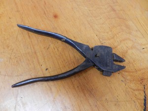

Thanks for the education on PW's! Did not know how they were different.
Sweet Pliers! What is the cost of the ones in the picture?
Here is a variation on the old crescent wrench idea.
I got a couple coming from Sears so will see how they work.
Had not heard of anybody using them?
The locking adjustable is a fantastic idea, just poorly executed in my experience.
In practice the Stanley version is so poorly made from the grottiest sloppiest Chinesium metallic residue that it's not nearly strong or precise enough to be useful.
If there were a version made by a reputable first-world brand like Irega, I'd be all over it. I haven't seen one -- there might be some sort of patent or licensing issue.
Let us know whether that Craftsman version is any better! I'm sure it's still Chinesium, but if it's decent Chinesium that could be a pretty useful tool.

I like an adjustable wrench but I would rather use a fixed combination wrench if I can. I like adjustable wrenches enough to allow them collect in my toolboxes. I doubt 50 Crescent and Monkey styles would be an exaggeration.
My favorite vintage adjustable and one that I never use, was given to me from the estate of a local machinist. He was a nice old guy. I met him when he walked his dog down my lane. He made the wrench while he was an apprentice in the1930s.
I have a few "Monkey style" adjustables with the name KING ****. This is probably not PC in this age of fragile persons.
