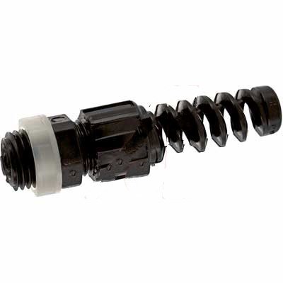

This is a snow Joe 322p- small corded electric snow blower. It started arcing last year when I was using It. I discovered the broken wire, just outside of the strain relief. ...put it away and figured I'd get to it later. It's later.
A replacement cord is not available through the manufacturer. Are these standard items? Can I source one knowing the wire gauge and size of the strain relief when it fits between the handle halves?

I have fixed a few tools with strain reliefs. On those tools, the strain relief is not bonded to the cable so I just slid the frayed outer cable up 6 inches and made new terminations inside the tool.

I have found that you can buy those types of cords with a plug molded on one end. You can replace the cord with a longer one (which sometimes is a real benefit) for a small amount of money.
Or, you can do as JimRB said and slide the strain relief up a ways, cut off the bad area, and re-connect the cord inside the tool.

Hubbell makes a cord strain relief in a miniature version that slides over a cable and tightens down for a water tight seal that is good to minus 30 deg F. They might have the dimension that you need. Plus, there are often eBay sellers who sell these items in single quantities. They are available with and without the spiral.

I've had a similar problem. The strain relief was not bonded to the cord (but stuck) so I set it on the floor, stepped on it, and rolled it back and forth under my foot. That released the strain relief and I did as suggested above, slid the strain relief down past the break and fixed the break inside the tool (just solder and shrink in my case).

Sometimes I can salvage the old strain relief by slitting it down the mold parting line and peeling it away from the power cord. I always try to do that because the molded end always seem to be made just for the tool that it's on.

Been there done that. I just checked and Superior Electric makes several sizes of the tapered rubber reliefs that are usually sticking out of power tools. Amazon has then for a few bucks each and I gave seen them for a buck and change. The problem is they are skimpy on specs like hole size but do state wires that will fit, like 14/3 or I6/2. I would call Superior, if I needed one, for more specs like actual wire grip range and panel thickness for the groove.
