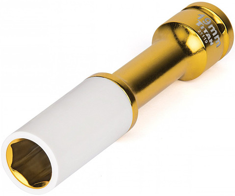

Greg5OH
Jun 24, 2014
196
What about these titan ones? less than 13 each via JB tool . CrMo, says can be used with impact. Lifetime warranty.
I have the 19 and 17. I dont have much impact time with them. Length is great though.
