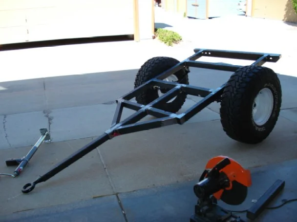

This was one of my projects. A buddy had a pretty old dilapidated snowmobile trailer. Wood was rotten, and I hated the fact, the tires were completely under the trailer. (I wish I had taken some pics of the rebuild) I stripped it down and made reinforcements where needed. I actually cut the sides off that hung over the tires. I was able to get some nice aluminum plate from where I worked. Having access to a CNC waterjet to cut out the panels I needed, the tailgate and the light covers. I used a roller to make my own wheel wells. I even formed up my own u-channels for the wood sides I added. Although i put them on the inside, I lose a little width but I liked the cleaner look on the outside. A fresh sheet of plywood and my signature foot to hold it in place when parked. It's not for everyone, but it has been perfect for hauling a rider mower or a snowblower when I needed. I still want to add a lock box to the front for straps, bungies, tarps, etc...
(First pic is just an example of what I started with)

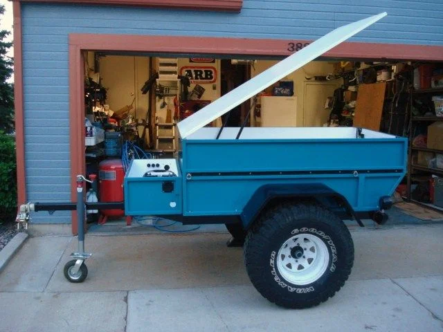

Truck frames are made from open section because you can't stamp a closed section. Current truck frames are trending towards closed sections that are more complicated to manufacture but superior performing.
Trailer frames are built from whatever provides the required stiffness for the minimum number of dollars, which is often channel. I wouldn't think it wise to read much into their crappy corrosion performance. I see lots of trailers that are so poorly made they didn't make it to Home Depot without rusting/bending/losing lights/etc.
Agreed, channel is only cheaper, nothing more. Tube is way stronger in the same wall thickness. Corrosion is best combatted with coatings.
2x2 will not fit inside 2.25 x 2.25 x 1/8, you will need some slop. You can buy specially made "receiver tube" from a steel supplier, or just use 2.5 x 2.5 x 3/16 wall which is much cheaper.
The extending tongue will not live long at 1/8 wall. Any slight bend will cause the tube to jam. I would use 3/16 or even 1/4 wall as there will be a lot of bending force from that long of a tongue.
Putting the receiver tube through the center of the frame is going to result in a huge amount of additional cutting and welding, and keeping everything aligned is going to be difficult without a jig or large welding table. I would just hang it on the bottom of the crossmembers.
As stated above, you are going to be able to fit about 2,500lbs of fire wood in there. I would definitely use at least a 3,500 lb axle, and would highly recommend a 5,200 lb axle as it uses 12" brakes, which your TJ is desperately going to need when the trailer is loaded.
As for sheet metal, I would probably use 11 gauge on the floor to prevent denting from the firewood, and maybe 14 gauge for the sides so long as you are going to build some type of rail at the top.
Jay
I agree wit,h most of what jay says here but often tube will fit in another depending on the seam inside the tube. You'll have to check it out at the steel yard. I would bump up to 1/4" wall on the extension pieces. I built a trailer with an adjustable tongue and this has worked very well for countless off road miles.
Your extendable tongue is going to cause you some problems and probably fail. with thicker metal it will take longer but the results will be the same depending on how you lock it down when extended. How were you going to do that? You cannot put a pin or bolt thru it, that would weaken it too much and it must be tight!
I disagree, this simply isn't true. If well designed and built it will be just as strong if not stronger than a solid tube due to the doubled up wall thickness. My slip joint tongue is 1/2" thick that the joint for over 2' overlap.

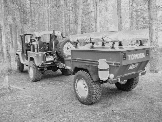

Here's what I built 5 years ago... It still working awesome.

^Thats basically what I'm wanting to build, Thanks for sharing the pics.
My trailer is still in design, but I hope to get started on it... when I finish everything else I'm working on.
