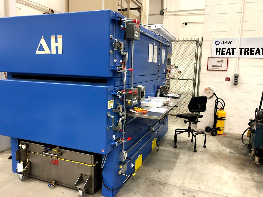

I have to agree with what a lot of others have posted, building a 400-450° oven that size for a commercial business is just asking for trouble. Even if you and your team are capable the liability would be huge.
I bought this heat treat oven for work just over a year ago.
It has a 400° aeging oven on top, the center is a 1200° solution oven and a roll out quench tank underneath. The solution oven will run at 250° from purely air friction with just the blower motor running. Large commercial ovens are all about airflow, its not as simple as just putting heat in a large container.
Delta-H the manufacturer was incredible to work with, I got weekly updates on the build process along with pictures. Once it was installed the company owner/designer came onsite for a week to test, setup and train five of my people on using the oven. We have his personal cell for questions or issues, which he has addressed in less than 24 hours. You wont see any powder coat ovens on their site but I'm fairly sure the owner told me they have built them. They are very similar to composite curing ovens.
This company is at the upper end of the spectrum, both in cost and performance. For example their ovens have to meet uniformity requirements that call for ±2° at any location to be certified as ASM Class 1 ovens.
We also have a 8'x8' Wisconsin walk in curing oven. It also has an air system which has baffles and vents that are individually adjustable to allow it a ±10° deviation at any location.
Wisconsin states:
Safety / legality concerns aside that would be a fairly tall order in a homemade oven the size you are looking to build.
