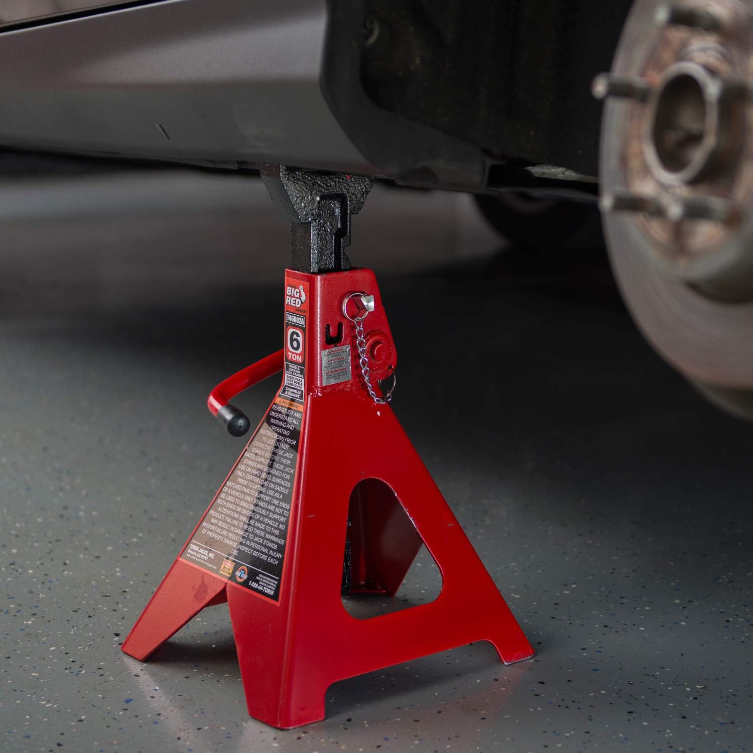

Geez guys, every single U-joint per-axle car, which would be what, 5,000,000+ VW air-cooled Beetles, had a 'defective design,' and that's not-even counting the 1960-1964 Corvairs which Ralph Nader labelled, 'unsafe at any-speed.' Better destroy them all, no adding EMPI 'Camber Compensators,' which reduced the tendency of the swing-axle to tuck on a sharp turn. Just like the Ford Explorers, on Firestone tires... . How-many other products are we gonna burn at the stake? Stay-away from my Jarts!
That's where the youtube star shows the teeth profile which are noticeably shallower than the new model from HFT.
My HFT 6-ton stands do-not resemble the 'shallow-tooth' beams, but I am going to return them so I can get new pieces to play-with. Then I'm going to burn my Corvair Monza Spyder convertible, before it kills-me (yes, I once owned one, turbo!).

I've looked-at 'the videos' on-here, and I've seen the obviously shallower teeth on the beam, of-which I posed a screenshot, along with one that doesn't have the 'shallow-tooth defective design.'
As I said, I looked at each of my jack-stands, and none of them have the shallow tooth design.
If the load on the beam overwhelms the engagement at the tooth, it's because of the shallow tooth, and not because of a structural failure of the pawl. The pawl has never been described as being the part causing the voluntary recall, it's the teeth on the beam being too-shallow.
Drilling two holes on the saddle, to place a steel pin, to prevent a properly-fabricated, to-design spec pawl from being able to-move until the pin is withdrawn, does provide a margin of safety not inherent in the design from the factory. Notice we're speaking of properly-manufactured equipment, not one made from worn tooling.

The Torin 6 ton jack stands I have look just like the HF versions, except mine have the triangular shaped hole for a triangular pin.
Looks like this:
