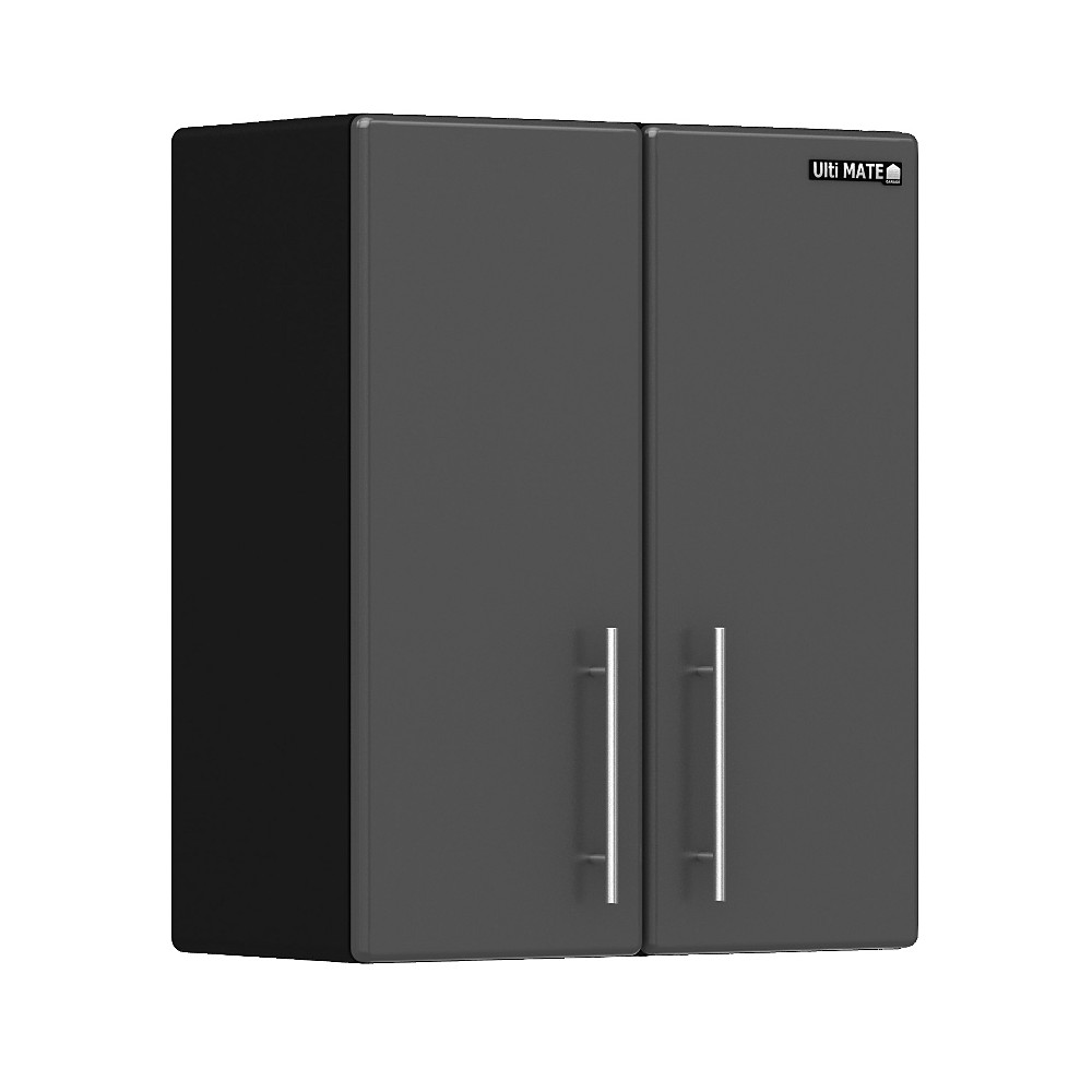

- mount nine new Ultimate Garage cabinets that purchased through Sears

Cabinets
http://s7.sears.com/is/image/Sears/00995118000?qlt=90,0&resMode=sharp&op_usm=0.9,0.5,0,0

As well for the cabinets, myself am a cheap ******* who knows that I could build better than brought. Maybe that an option too?

Great progress. From the pictures, it looks like the wall cabinets are mounted fairly high?

I did this on purpose... Since the garage is so small for a two car, I didn't want to hit my shoulder or head when I get out of the cars... plus I'm over six foot, so the extra height doesn't bug me. I"m also building a 42" high workbench and didn't want a really small space between the work surface and rear cabinets.
