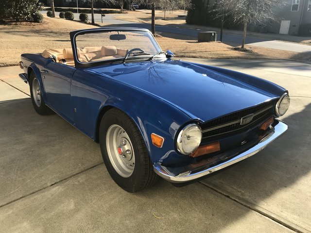

I shot the TR6 in the garage (in an HOA even, shocking to some on here) with a Devilbiss FLG4. The paint is far from perfect, and would not be considered show quality to any knowledgable eye. But I wanted to see if I could do a frame off / nut-bolt by myself. Painting is 1 part science, 3 parts art, so be prepared for some practice, frustration, etc. The TR6 was shot with BC/CC, I later shot the Formula Ford with SS, figuring it would be easier to touch up / repaint given it's use. I didn't go with the Dekups system, but in the end I probably should have. I used the disposable cups that HF sells. Probably more expensive in the long run, but cheaper for my infrequent usage.
And remember that modern paint is VERY nasty stuff. I'm not sure I'd shoot modern paint with just a 1/2 respirator. I used the HobbyAir supplied air system, and felt much more comfortable with that.
