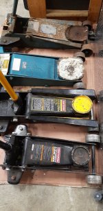

Here's the ones I have
The green-ish Sears jack is my favorite
That middle 3.5 ton looks just like the one I just rebuilt, mine was model 50145.
I bought the kit from Lazzar's HCRC Now online. It was about $30.

Top jack is a Walker/Lincoln, likely some version of the 93632 or 93630. Second one from top looks to me that it is probably a Blackhawk relabel, maybe SJ1 or SJ2. Third from top looks like a Shinn Fu design. Bottom one looks to be one of the Chinese (probably Torin) copies of Japanese Yasui design.
I would think that the top two would have available seal kits from different vendors somewhere. For the bottom one, pretty sure you will have to disassemble first to measure seals.
Walker rebuild thread by @GeorgiaHybrid:
Here is a rebuild/refurbish thread of a Blackhawk SJ2 by @paulsomlo :
Hiball’s Yasui rebuild thread:

@ajchien is correct - the green Sears jack (2nd one down) is indeed a Blackhawk, made in USA. I can't read the label, but if it says "1 1/2 ton", it's a SJ2. It's a very simple jack, takes a single U cup on the ram. The difficulty in servicing these is removing the tank nut - it's a rounded and scalloped affair. I used a 3' pipe wrench to remove it, my rebuild thread has info on it. Ignore the machine work that I did on it, unless you have access to a lathe and are looking for a project.
The uppermost jack is maybe the best of the bunch and possibly the easiest to find a rebuild kit for.
Top jack being a Walker / Lincoln is defiantly the one I would do first as they are lifetime jacks for sure.
