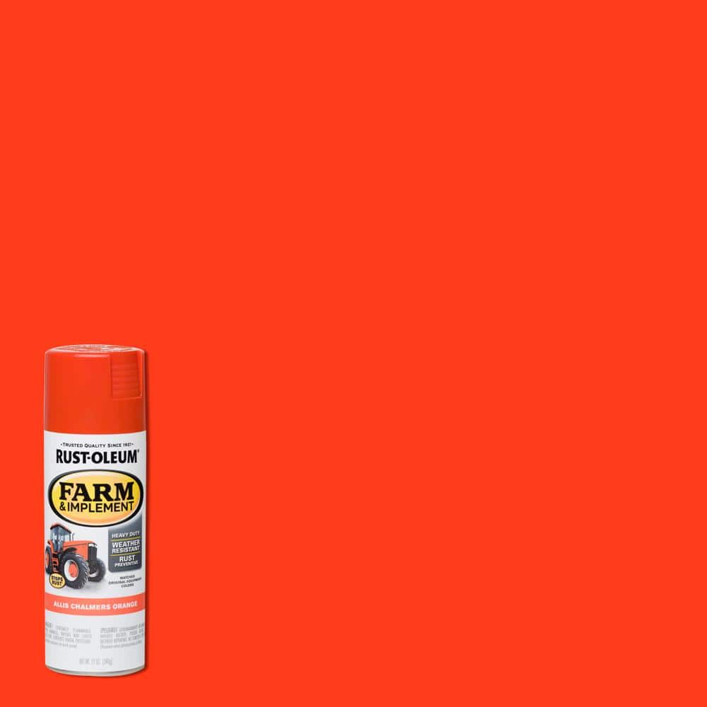

I think the Rustoleum Farm & Implement Spray Paint Allis Chalmers Orange 12 oz is a really good match to the original HW paint.
Home Depot offers 6 cans for $26.88 with free delivery. Much lower price than other stores and most only had one can in stock. Please share some pics in the thread.
