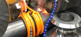

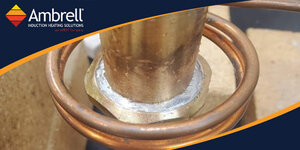

Get the induction heater. No flame but the tube is soldered in. No room issues because you can mold the inductor.
Get a tool that has many uses.
An induction heater for soldering plumbing? Interesting, never seen that
I've never heard of that either. Interesting.
