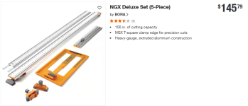

I recently bought a bora straight edge and saw plate for a project. I haven’t used it yet. I can chime in after I use which may be tomorrow or next weekend if I don’t be lazy.
I previously had a generic aluminum track that sucked. I cut it up and threw it away when I got the bora.
I believe the bora and saw plate for it was about $90 total. I think it was $68 if you don’t want the saw plate. It does break down to 48“ sections.
I’ve used a 6’ level, 4’ level and a piece of unistrut more than anything.

I use a Bora 100" (2 pieces @ 50") and I've been happy with it. Disclaimer: I've only used the 2nd piece to rip full sheets a handful of times. I usually cross cut a full sheet so that I can handle it easier in a table saw.
$67 today and worth every bit IMO.

I've used Bora clamps for years and never had any issues withe them. I have three different lengths and need to get the 100" yet. I can use any of my saws with them including my jig saw, router, etc. I also us them for other things like drawing lines or clamping things. I see Harbor Freight now has their own version and a lower price point.
