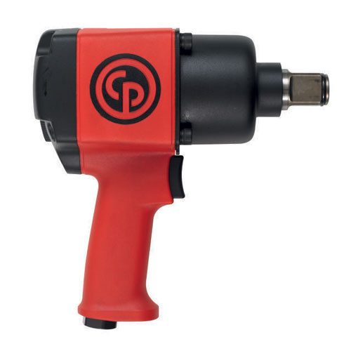

I have a CP 796 that needs the housing replaced. The housing is about $550 and $25 for valve and seals. It came from a railroad purchasing agent's retirement auction. The paint looks like it may not have been used. $100 and shipping. I have a twin to it that I use a few times a year. I also have an IR long shaft for truck wheels. My 796 will snap 7/8" bolts if you don't soak them before trying to break them loose, It's a beast even compared to an 1" long gun.
https://www.amazon.com/dp/B000NP0RSM/?tag=atomicindus08-20
That CP 796 is quite a tool for sure. Industrial Model no. is a 611. Output 2800 FT LB. MAX. working torque 1800 FT. LB.
That's a great price on Amazon. Right around the cost to small distributors.
