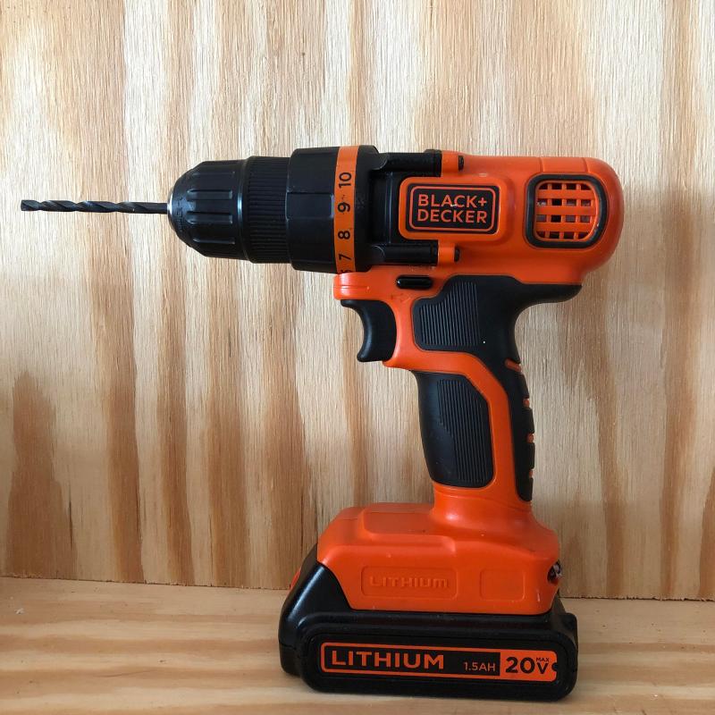

Bought myself a Black and Decker 20vdc drill in 2013 and still have it. The B&D weedwacker uses the same battery so I bought that in 2014. All still work and batteries still hold a charge but the drill is not brushless...will get a puff of carbon once in a while.
145836e9-c892-514a-93c8-1b639692b21f
So in 2020, I bought another drill and regulated the old one to basement work on my model railroad framework and such....so glad I didn't spend over $40 for a drill.
Using batteries on multiple tool platforms...."PRICELESS!"

That orange B&D in the pic above run 3 inch deck screws no sweat. The 50$ drill now will. They aint as heavy as my 28 but,,, they aint as heavy as those. Feel like a toy but they work well and so much nicer for common screw and ligbt drill work including steel to 3/8 or so.
