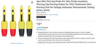

I have a number of multimeters, fluke down to cheapie chinese and they all do pretty much the same thing for basic needs.
It is worth having at least one spare cheapo meter and some decent leads with both probes and alligator clips.
I have some piercing probes already, but I just bought these as spares.
I should have mentioned that I usually replace the leads with better ones if I plan to use the meter more than once or twice a year. There is a guy that makes leads and other test cables that are very nice and well made for those that are interested. PartsCandy.com The probes and test leads are the best I have ever used.

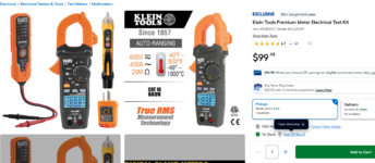

I’m in over my head a bit but want to learn. The clamp meter will allow me to measure the in rush current on the 10hp (FLA 43), a clamp meter is like a sledge hammer where a multimeter is a good ball peen, both are good to have but the DMM’s top out at 10amps.
Installing a 50amp dual pole breaker and contactor then the 10hp I’d like to be able to test what’s being drawn.
I’m at the upper end of my homes capacity and may need to go down to a 7.5hp or 5hp to be safe. I’m not understanding how else to measure high amp draw other than with the clamp style.
My main is 200amp, my subpanel is 100amp. I have the room in the panel for the dual pole, but I want to make sure that I am not going to burn my house down trying to install an air compressor in the garage. 😂
I’ve been studying meters, I want a used Fluke 87V. But if I can’t find one of those then a new Brymen B235 would be more than sufficient as a multimeter.
The clamp meter is a multitool, good at big amps and poor at measuring low signals and not meant to be a bench test meter.
The Klein CL800/810 seems to be a fantastic option for this task. I can’t buy all the stuff I want yet, so I’m buying it one step at a time.
I want a clamp meter, multimeter and oscilloscope. But for now I think the best thing is to get the clamp first to allow me to get through this task then on to the next. My thought was buying the most valuable I wouldn’t lose out much if it wasn’t needed after the job. I bought a nice LCR meter when I recapped crossovers in my HiFi system and was able to get a lot of my money back.
I may find that it’s a tool that I don’t want to be without, but primarily just want to get this job done to the best of my ability.
If I’m mistaken then by all means feel free to correct me.
I do have a cheapo DMM with nice leads, that is somewhat sufficient. (Better than nothing)

I started this project reaching out to the power company with the details on the motor and my panel, they said I have zero limitations on the feed side. Not that I trust what they say, but that's what I was told. I want to test everything prior to moving this monster compressor into it's place so if I can't use it there is minimal back and forth. The 10hp is monstrous, and I've been told the single phase 10hp aren't known for longevity so my thought is use it for the time being with a long term plan of going to a 5hp-7.5hp.
As much as I like the idea of getting a fluke for long term dependability I think the Klien is going to be a better choice for this, because the equivalent fluke is not in my price range.
