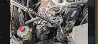

My Honda CRV's PS pump needs replacing and my new part does not come with a pulley. I do not own a impact drill so I will need a tool to help in removing pulley. I was looking at the Gearwrench 3900 pulley holder but it looks like it is more for removing fan clutch's, not sure if it will work? But, lets say I wanted to get an impact wrench. Would the Milwaukee 2962-20 1/2" mid-torque impact wrench do the job?

I just did a 98 accord's PS pump rebuild. If its the same setup I just slid a 3/8 extension through the pulley to keep it from moving and then used a wrench on the nut. Super easy.
Are you saying that you removed the pully first while pump was still installed using 3/8 ext. to hold in place, then remove old pump, then install new pump, then install pully?

It's splined and just stays in place with a nut.
Remove the pump, place in vise, remove pulley, reinstall onto new pump, install new pump. No puller to special tool required.
Yep. A lot of them work like that. You can also use a prybar or screwdriver to hold the pulley if it has slots cut into it.
Just keep the pump and pulley from moving and remove the nut.
I know some of them are pressed on, but another member said free loaner tools are available at your local auto parts store should you need them or go to HF.

Tip crack the nut loose before taking the belt off.
Yes. That was the easiest way to go about doing it. Took about 5 seconds.
