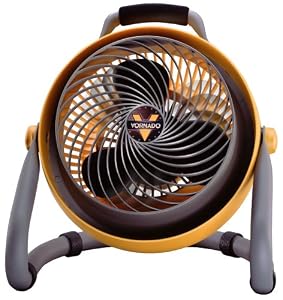

Buy 4 of these and put 2 in the windows blowing out and 2 mounted on the walls to move some air around. For about $520 at least you will be moving some serious air for cheap money. I bought mine on Amazon for $130 each.
