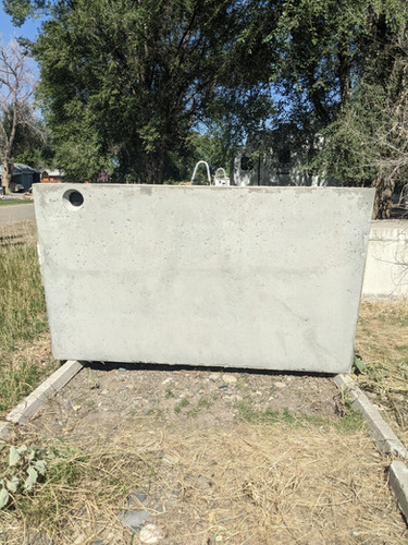

Take the septic tank idea and tip it 90degrees. Build one wall with a commercial metal door and frame for access.
You still probably will be in this more than a Conex but smaller volume to condition.

Maybe buy a concrete septic tank and put a door in it?
Interesting idea ! You don't want a "traditional" tank because it have two chambers. Get one that has only one chamber. Burying it and running all of the wiring underground will make it kind of "stealthy" !
The biggest issue will be securing the door. Nothing short of a bank vault door can stop an angle grinder and the time/privacy to use it ! Hidden exterior and interior cameras will not stop a break in, but at least you will have evidence.

If you're considering a concrete septic tank, how about a vault, the kind the telcos use? Designed to be installed underground which may make it easier to reduce the issue with thieves.
The thieves brings up another point about your criteria. If thieves are a big issue, maybe that should be a higher priority than the cost.
sticking it in the ground would also go a long way towards moderating temperature extremes, too.
Bury it with the panels overhead above ground and you also hide and limit access to the structure. Place it so the equipment vault is shaded by the panels in summer.
Throw some 'junk' on top of the vault, let the weeds / grass grow tall around the edges, it will just look like a junk pile.

A buried electrical vault for the batteries, inverter, and charge controller would solve the temperature issue. A real man cave. But possible flooding, humidity control, and access issues have stopped me.
