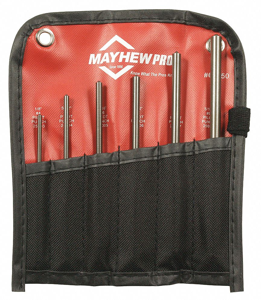

My set of Mayhews I bought a month ago, not so well. Punches have had no issues, but the chisels have sadly dented into the edge with every use. Haven't held up any better than my buddy's HF set.
gotta watch out, there are different grades of mayhew. including an "economy" line.
and a premium line
http://www.toolsdelivered.com/Mayhew-15001-Hand-Tools-Chisels-and-Punches-Chisel-and-Punch-Sets
http://www.amazon.com/dp/B000IKN7LG/?tag=atomicindus08-20

there is also a mid range "pro" set. about 1/2 price of 150 series, and double price of select diyer series. those are the ones most own.

I recently bought a set of the Mahew "PRO" chisels and I think they are garbage.
Not sure about the "PRO" punches, but I wouldn't hold my breath.
