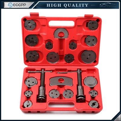

Does anyone have this Icon brake tool kit for wind back caliper pistons?
What's your opinion? Is there a difference or advantage of using/owning this kit vs. a similar and cheaper kit on Amazon?
The Icon has a lifetime warranty and HF is local. Also Icon is made in Taiwan if I'm not mistaken... Most of the kits on Amazon are from generic Chinese brand names and clearly most are made by the same manufacturer(s) and sold by random companies.
Does this justify the more expensive Icon kit? Or is there a just as good and cheaper alternative?
Note: I am specifically referencing kits that include capability for both LF and RH twist. Also NOT including pneumatic options.

The Astro set (#78618) set is almost identical for a hair under $40. I think it is missing the triangular (3 pin) adapter.
The finish on that ICON set looks nice though.

There used to be a Pittsburgh set for less than $30 that's a great little set but, I think it's discontinued.
That's what I had. Now I'm pneumatic and loving it.
Frankly left/right isn't a huge deal, you can use a left or right for either, your technique just has to change. If it doesn't twist in, just reverse your twist. Tighten the nut, twist, tighten. It really doesn't matter you're loosening the tool a bit when winding in, because the next time you apply force you compress it anyways.

The OMT offering is definitely popular on Amazon. I'm curious if there is any build quality differences between Icon and OMT, besides COO (if it's actually different). Otherwise I think the OMT is going to be the kit I pick up based on my needs and expected frequency of use.
There is a Maddox set now. Around $40. Smaller than the Icon, less adapters.
For my needs pneumatic is not needed and a no-go outside of a shop (for me).
As for the LH twist, I don't expect to use it or need it, but I was thinking might as well go for a kit that has both if I'm going to buy one.
To be frank, although my professional shop experience is limited compared to some of you guys, I've only across twist in caliper pistons a handful of times. However I was trying to help a family member and her car have those damn twist in pistons.
I'm done wrenching professionally, and I expect to use this kit even less than I did before, but I want to have one more easily/quickly available should the need arise.

Pneumatic tools in general **** if you don't have air. In my experience all of the basic wind-back tools are pretty similar. If one has an issue with the tool holding up, the caliper in question just needs replaced.

I will say the Icon kit comes in a real nice case. That was worth the few extra $$$ to me, since it was purchased to live in the car trailer for track events.
Other than that, the other commodity kits work just fine.

I ended up getting the Icon case simply because the coupon put it close enough to the price of the amazon ones, and I liked the nicer case. Of course once I got it, the family member who's car I bought it for sold it.

got the old pitsburg one also, works fine.. this icon one looks better.. I think the left hand winding ones are for those German cars.. like BMW or Porsche, not too sure.. the regular one services the vw and Honda fine. mostly for rear brakes that you can not just compress the piston in. you have to twist and push. I did bend the handle when the caliper froze up with the piston internals crapped out... but that was not the fault of the tool. (initially I blame the tool, and not the gorilla)

does the pneumatic tool twist and push that is needed for some of the brakes ? or just compress. all front brakes compress but some rear brakes, need to be twist and push to retract the caliper pistons.

The pneumatic unit I have provides the push, you still manually twist it. Spin it a bit, press the trigger, spin it a bit, press the trigger. I'm very pleased with it and it's saved a lot of wear on my wrists. I wish I had jumped on the bandwagon earlier when these tools became available.
ARES 18023 is the one I have, bought it in May 2021. I'm sure it's seen hundreds of rear calipers.

I have an ancient HF kit, and it works fine; but as a home user, I don't use it very often; I think the last time I had to wind back a rear caliper was on an Outback about a year ago. I'd bet that all of the generic kits on Amazon will be fine for occasional use and they're probably all the same quality. If I was going to buy today, I'd get the one I linked, or an identical one in a different colored case.

I did the rear brakes on my Mini a few weeks ago and they had the &@Y#@$ twist-in calipers. I hate those. My old kit (not sure who made it) didn't have a plate that seemed to work, so I had to buy this funky cube thing (Lisle, I think).
I hate those style of brakes...
Next time there's a 30% off Icon coupon, I'll eyeball that kit again - nicely-finished and very nice case. The OMT kit might win anyway.

I guess with a coupon the ICON kit is fairly reasonable buy if you appreciate the better case and like the potential long term warranty .
Little bit of effort on eBay, Amazon or Aliexpress will get a totally usable set for 20 to 25 bucks, it certainly one of those tools that a low cost option can work just fine .

I have the Maddox kit, and it's perfectly fine.
The Icon kit includes the left-hand thread widget and a few more adapters for wider compatibility. Price seems perfectly reasonable. It's on the shelf nearby in any town with at least one traffic light... what's not to like here?
As to that Lang tool, I'm not a fan of it or that style in general because it often just doesn't fit. Maybe I work on smaller cars than other folks or something.

There's zero reason to spend much more than $25 on a wind back kit. It's a very simple tool. Most of these kits are just the same rebranded tool anyways.

The main thing is the design. It doesn't use that skinny handle that you have to turn with your hands. It gives you a provision to turn the tool with a wrench. Have you ever tried to turn a little small C-clamp with a skinny handle? It's not fun.
It has a hex end, not on the screw itself, but should still work
Idk, I opted for the “BILITOOLS” variant which has a 10mm on the very end. Good enough for the one time a year I do someone’s brakes

I have the same one just in a red blow mold case. It works fine for most passenger cars, used it last on a Jeep Cherokee. I have always used the old brake pad and C-Clamp but sprung for this one when I had an Audi. Its worth having if you have the space.
That being said, I like the beefy looking Icon one and the fact that the case can be taken apart for use in a drawer is a nice feature. I have a rolling tool car from HF that is my "auto repair" box. I'm just a DIYer, so the cart isn't full and I have plenty of room for storage below on the shelf.
Overall, at $20, if you do brakes, even every other year, it is worth it to have the set. If I was looking for a set right now, I'd be tempted on the Icon one at 30% off for sure. When was that coupon offered?
