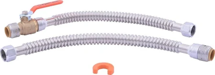

To wrap this up. I found that sharkbite make a 24” heater hose in 3/4”. It has a 5” bending radius and took the corner gracefully.
I can drain the entire plumbing system from the waste drain in this valve.
