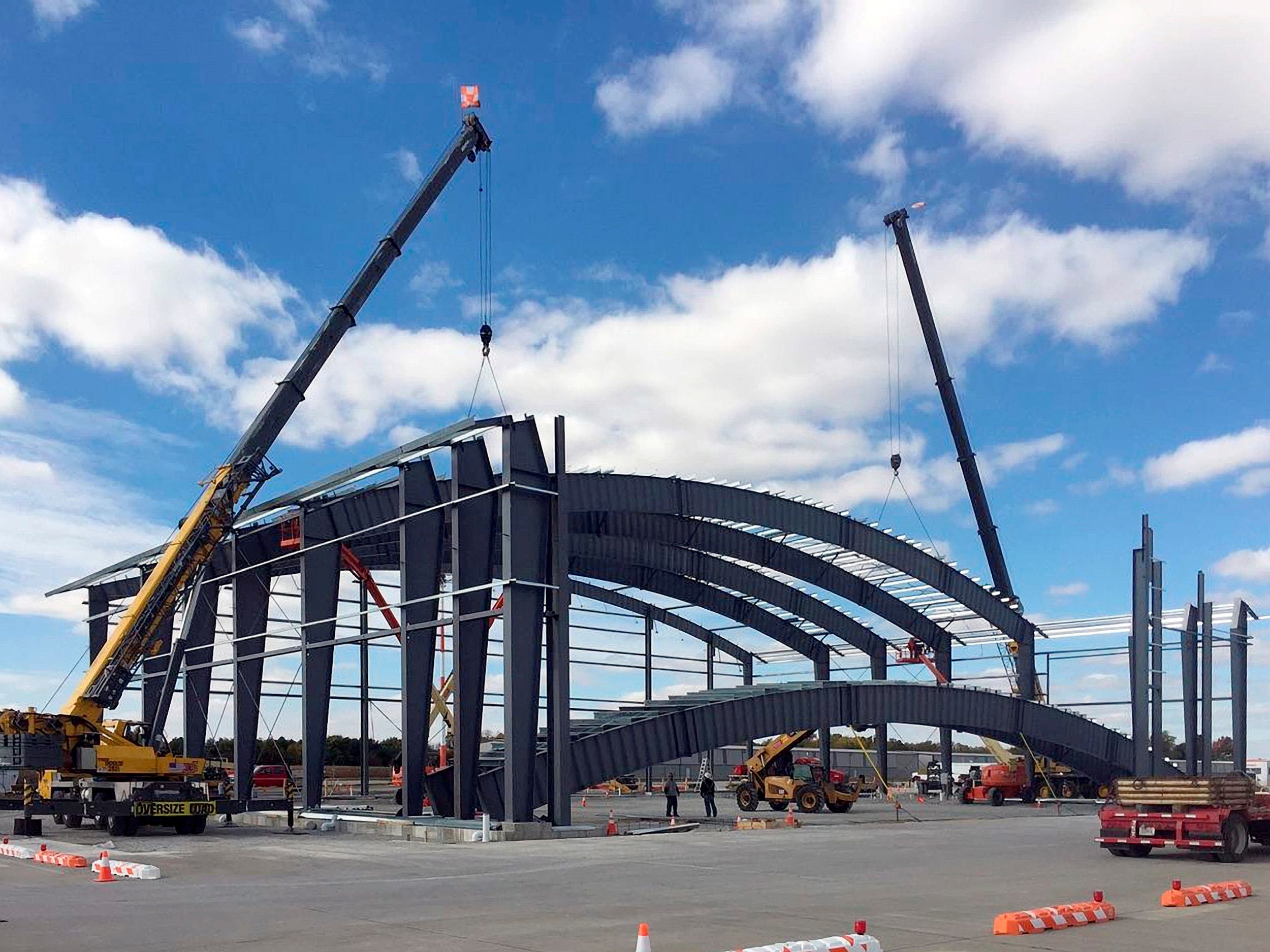

I wouldn't look at any other buildings other than a "red iron" building for that size. The metal bldg packages seem super economical at first for gaining square footage, just realize you'll likely have that much in concrete as well.
The big metal buildings are the go-to, but I'd like something a bit nicer than a big metal box. Maybe I'll look up how people have made the outsides of those kinds of buildings a bit fancier than normal.
You can add soffits (overhangs) and get something like a 3:12 pitch roof, in order to make it look more like a traditional building. It doesn't have to be a 0.5:12 pitch with no overhang. You will need a salesperson who can carry this to "engineering" so they can quote on it. You can add brick or faux stone wainscoting on one side to also improve the looks of your build.
Depending on how many projects and how many "runners" you have, you might have to have a center aisle with overhead doors on both ends and then everything diagonal-parks right and left of the center aisle. That way everything is accessible and you can put various car lifts to support projects. Or it could be a large number of individual overhead doors. One bay in the metal building typically doesn't have any doors so the X-bracing (cables) can be installed.

If you want something other than the usual tin box, check out these guys. I think the smallest span they do is 60ft.. so there's ya 60x100 or 75x80.

Do you have any pics? I'd love to see what $400k buys. I'll be doing this in nowhereville texas so maybe that will help me save a buck, at least on the land. I'm moving away from these sky high city land taxes. I'd rather just give the money away than let the... well you know.
