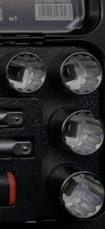

Can anyone give me details about this unusual Craftsman socket and wrench set? I've done some searching, but haven't found any information, only a couple of auction site photos.
Are these just an oddly-cut version of 12-point sockets and wrenches?

Look up “spline drive” wrenches and sockets. I have several sets of these made by Wurth. I have no issues using these but some claim they can damage certain types of hardware in various states of rust / corrosion.

+1 on Universal. I have a set of deep ones. I thought I'd get something different so I'd have deep, 6-point, 12-point and shallow in my arsenal of tools. They work on square nuts. I've never worked them hard, so no info on how robust they are.

I had that exact set at one time. I sold it about 10 years ago. Don't think I used it.
Attached an old picture I found in my OfferUp archive.

They called them Universal
That led me to this video review of a 1/4" socket set that appears to be from the same product lineup:
So, it sounds like they work on six-point, four-point, and eight-point fasteners, plus actual spline drive fasteners.
