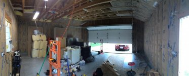

Hey guys,
Long time viewer, first-time poster.
My father's 60th birthday is coming up and my brothers and I decided that we're going to redo his garage for his birthday while he is out of town.
One of the first things we want to do is insulate the garage that he uses to restore classic cars. Right now the garage has no insulation (besides the walls) and has quite tall rafters.
From my research, I understand that pretty much all insulation needs to be covered by sheetrock or wood. However, not sure how feasible that would be in this garage. Is there any insulation that can be used without the need of protective sheetrock?
I'm open to all ideas, we are trying to do this on a budget, but I'm open to all types of ideas. We just want it retain some heat when he is using his electric heater. I have attached some photos of the garage.

Closed cell spray foam does fine when exposed. You could spray a couple of inches on the under side of the roof. There are a couple of downsides to this
#1 is cost
#2 is if the roof leaks closed cell foam can trap moisture in the roof deck leading to rot.
#3 ice damming could be a possibility depending on the circumstances.

Code might mandate drywall but if not the cheapest and fastest way I can think of is fiberglass covered with thin lauan sheets and if the joints are an eyesore use some 1x strips to cover them up.

I would not insulate the roof. The roof is real high and the warm air from the heater will end up by the ceiling where it won't do your dad any good.
To do your dad a good deed and warm up the building to make it comfortable for working, you would need to lower the ceiling. If you lower the ceiling, and insulate it, you will trap the warm air from the heater down lower to the floor where it will do the most good. It will cost more money to do it this way, but your dad will be warmer and the cost of the heat should go down since the heater won't have to heat as much space.

What about 2"/3"/4" rigid insulation cut to a friction-fit-width and forced between the roof rafters? But not all the way to the battens, so as to create an air gap?

Okay so we're looking at possibly lowering the ceiling by installing some type of wood or sheetrock on the or below the rafters. Then installing the insulation on top of that.
CombatNinja
Aug 24, 2013
1,456
You're on the right track. That rigid foam is typically R6 or so per inch. Those 2 3/4" will only get you in the neighborhood of R16. Factor in imperfect fitment for air gaps and the fact that the installation above leaves all the framing open for thermal bridging and you will end up at less then R12 in the end, not what you want for a ceiling in a Wisconsin winter.
You need to get some kind of ceiling in and get some nice R38 in there with full coverage, even R60 if you really want it to get snug. The ceiling is vastly more important than the walls when it comes to heat loss due to the chimney effect. Your Dad is getting to that age where the cold will start impacting his ability to get out there and use his garage if it hasn't already. You lot sound like a good group of sons that want to do something nice for the old man. If you're going to put the effort and expense out, do it right. None of you are going to sit around over a whiskey the day you bury Dad and lament the extra money or time it took to make Dad's shop warm. I bet you will talk about all the good times you guys had in the garage though.
