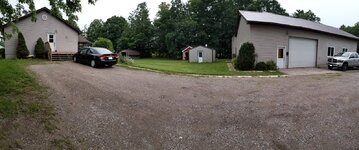

My property came with an existing hydronic heat setup that is based around an outdoor wood boiler. Most of the things in the setup are working, I got to experience the comfort of radiant heat, and put a bit of the internet learning I did here to practise. There are a number of things I want to change, but I'm not sure about my high level plan. I'd like to have a rough idea of what I'm doing before I decide if I'll DiY or so I'm better armed to find an expert.
Here's how everything is set up now:
On the left, house (small bungalow). Middle right, foreground, is the wood boiler outbuilding. On the right, shop (one big open area) + shop apartment (ground floor + 3 bedroom upstairs) in one building. Things were built to early 2000s standards and the insulation is quite good, save for the boiler out building which is just metal siding over a dirt floor (I have since torn it down). Under the boiler is where insulated and buried pipes come up. On the left with the blue pipes goes to the shop building, the right side has the lines which go to the house.
I'll take you through to the house now...

Here's where I'd like to go:
- Get rid of the wood boiler. I'm convinced no real maintenance was ever done to it. Replace with a natural gas boiler or boiler(s).
- Turn open primary loop system into proper closed loop with primary/secondary piping, expansion tanks, clean up the manifolds, etc
- Connect house heat load back up to the boiler system
- Zone upstairs/downstairs of each living space separately (i.e. to keep unoccupied areas cooler)
- Proper thermostats for radiant heat
- During heating season, pre-heat the DHW for the shop living space (electric water heater in same room as manifolds)
- Have enough capacity for 3 additional zones (2 additional outbuildings and a planned mud room addition to front of house)
My initial plan is to build a proper insulated shed, with heated slab, in place of the OWB building (this is one of the future zones), and install a big natural gas fired boiler. Its a central location to all existing and planned heat loads, and doesn't take up precious shop space! I'd put all zones in their own secondary loop. I thought about a buffer tank, in the primary loop, to avoid short cycling the boiler.
The other thinkable strategy is putting separate boilers in each building... that seems like it would be more expensive in the end, and would require me to run natural gas into each building. I'd like to avoid both of those things if possible.
Is my thinking on the right track? What would you do? Any ideas I'm overlooking? I'd love to hear what the minds of GJ have to say
