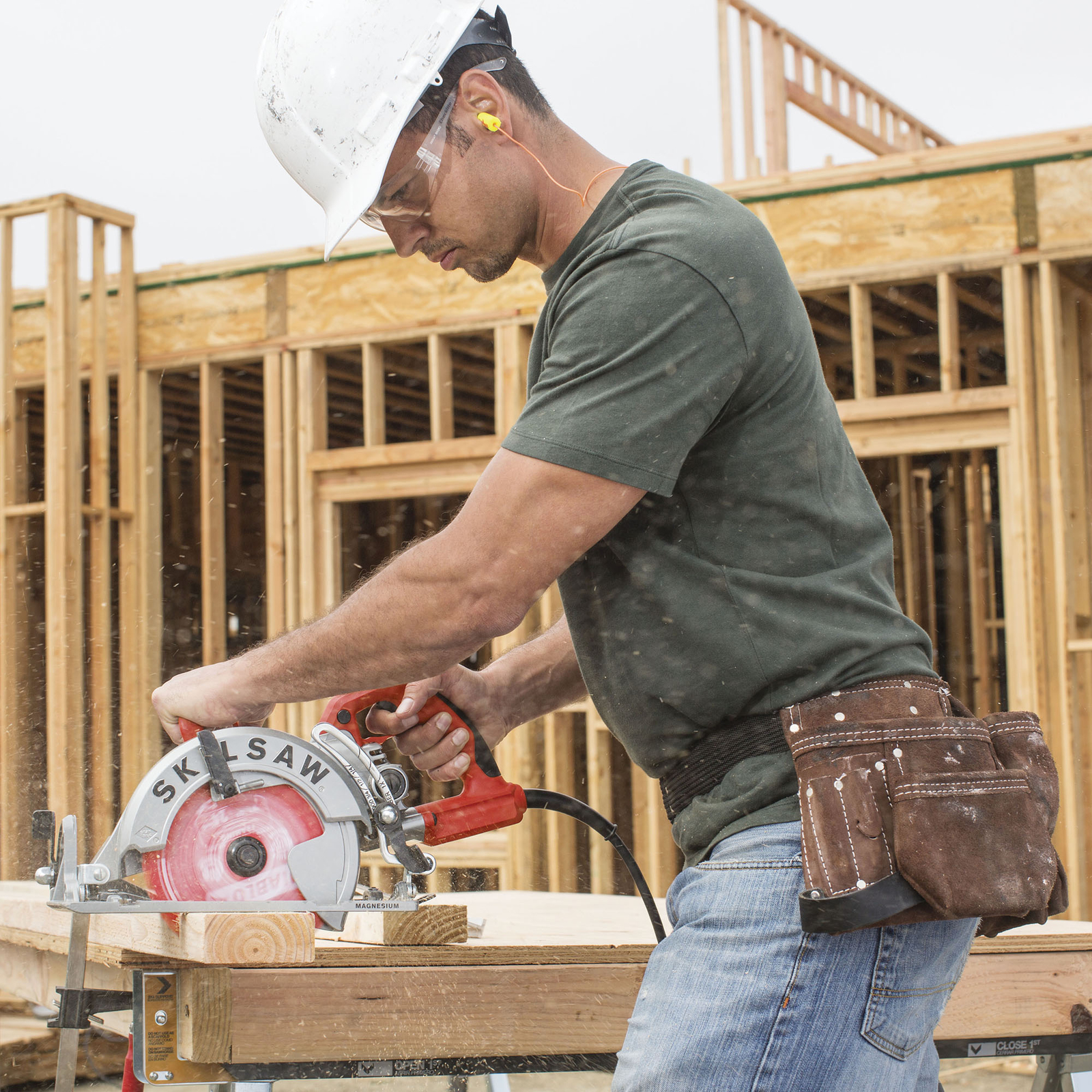

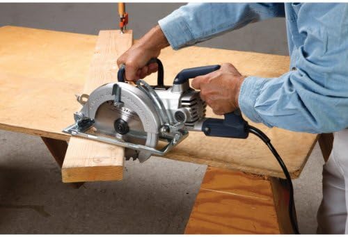

You cross cut the lumber the same way, motor on the piece that is "hanging in the air". If you think you are going crooked, use a square as a guide.
Best I can come up with for a picture via google:
In all of these pics the cut line is on the far side of the blade (unless the measurement you pulled accounts for the kerf). I know it's not a finish saw, but it still would be a lot easier imho if the cut line was between the user and the blade.

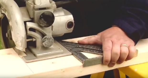

Orient your board so the part your are keeping is to your left. Toss a speed square on the board and measure the cut length, align the speed square 1.5 inches short from desired cut length. Cut with the worm saw in right hand, riding along the speed square (held with left hand).
Perfect square cut every time, no need to have a pencil or mark anything. Worm saws have the table 1.5 inches from the edge of the blade. No need to try and see anything while cutting means less chance of getting **** in your eyes, and less chance of messing up the cut because you can't see **** because you're old.
