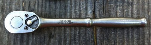

So today I head out on a pawn shop tool crawl and I come upon a 1/4 drive Snap-On ratchet marked TM 70 B made in USA with a letter E just below the the bottom ring of the handle. The marked price was $19.oo.
I ask to check it out and find that it only works in one direction and just spins in the other. A little more fidgeting and it's fully locked and doesn't ratchet in either direction. The pawn girl tries it and agrees - broken. I make an offer of $5 and she gladly accepts. So I slide a fin across the counter and out the door I went! I get it home, open it up, give it a good cleaning and lube and now it sings beautifully with no broken or chipped teeth.
I've tried researching it but only find TM 70 B models listed as being made in Canada and no references to the letter E. The shape of the 7 seems to indicate the year 1977 but I can't be sure. Can anybody into these things provide anymore info?
View media item 106245View media item 106246View media item 106248
16,660
The date code is normally located between the on and off below the direction control. The E may indicate that it was exchanged at some point.
13,383
Good work in jamming it up tight, probably saved you $5 or more from just working one way.

Thanks, your input is much appreciated. However old it is I'm happy with it. I guess it isn't everyday that you run into a $5 Snap-On ratchet in extremely good condition.

I think that "E" indicates it was made for the military. Not 100% sure on that. I have a 3/8 ratchet and a 1/2 breaker bar that I picked up at the flea market, and they both have the military code stamped on them. No warranty on the military stuff, but my Snap On guy was nice enough to install a rebuild kit in the ratchet, at no charge.

E is definitely for an exchange unit. I have twi 3/8" drive ratchets from the early 1960s that had the original date stamps from the 1950s which were partly obliterated and restamped on the shanks with the E

I've seen a few conversations about this E. It was used for this E-xchange progam mentioned, which from what I could glean started in the 1960s.
However, the Collecting Snap-on site lists an E as a date code for 1944. I have yet to encounter a definitive explanation for distinguishing between the two. Perhaps someone can produce a WW2 example showing the difference.

Since there was no exchange program during WW2, they just stamped the E on the side of the 1/4” ratchets. On 3/8” drive wartime sockets, it was stamped in the conventional location by the control lever.
Thanks Don! I never could get a definitive answer to this. When you say "3/8 sockets" do you mean the ratchet?

Oops, I haven’t had my second cup of coffee yet. I meant 3/8” drive Ferret ratchets. Here is one. Thanks to Shiftless for the kudos.

Since the OP's ratchet was not made in the 1940's, I am confused why we're even talking about date code placement on midget ratchets during WWII. While most midget ratchets were date-coded in the selector switch area during that time, as Don alluded to, not all of them were. One of my wartime midget ratchets was date coded on the bottom of the handle with a "3" (1943).
But again, that topic is unnecessarily confusing, since the OP's ratchet is clearly a much later ratchet. That "E" is not a 1944 date code "E"; it is an Exchanged "E" just as Rick Joe and MShaw stated.
And the 1944 "E" date code does not serve the same purpose as the later (50's-80's) "E" codes used to indicate that a broken ratchet had been exchanged, usually for another previously broken and factory rebuilt ratchet.
(Tangentially, no definitive evidence has ever been found that spells out the meaning of the wartime "E" and "G" codes. The most popular theories relate the "E" to the "Emergency" term that the OEM (later the WPB) used for the early period of the war, which does not coincide with 1944, when we were in the "Victory" period. I am convinced there is a governmental meaning beyond Snap-on, however, as I have said before, a theory given much credecne by the almost lockstep correlation to the way Duro-Chrome marked its ignition set wrenches at this time, with an "E" prefix to the model numbers beginning in 1941 through 1944, switching to a "G" prefix in 1945.)
Contrary to popular yet erroneous belief, a mistake that not even modern Snap-on truck franchisees are immune to, the "E" and "G" codes on wartime ratchets do NOT indicate military production. ALL Snap-on tools made in 1944 (and, as some of us believe, mid- to late 1943), and 1945 have these date codes. There was no separate date code system to distinguish military from commercial and industrial tools production, and Snap-on indisputably produced tools for commercial and industrial markets during WWII.

I don't see anyone here having a 'discussion' about the E code on a 1/4 wartime ratchet. I asked if someone could show me a photo of a wartime E code to distinguish it from the later exchange code, as I had never personally seen one. I already knew there was a distinction (an awareness also seen from others in the thread), which is why I asked. Don obliged by showing me a 1/4 war ratchet and explaining where the mark would be on the larger sizes, both for which I'm grateful. This does not comprise a discussion about wartime codes on 1/4" ratchets, so there's no need to wonder further about that (kind of like offering a solution to a problem that doesn't exist). My question was motivated by the fact that I sincerely wanted to visually see the distinction, which Don graciously provided. I'd imagine that other readers may benefit as well.
Other posters also identified OP's ratchet as an exchange, so we're good there too. Thanks for adding your voice to that group.
I believe most of us use the dating chart from the authoritative Collecting Snap-on site to date the G and E wartime marks. While any authority can be mistaken (ANY authority, as you know), the community really has no other equally authoritative published reference to which to refer. I read your excellent study on debunking the AA dates for the Plomb lawsuit wrenches. Perhaps you might publish one on the SO G and E marks as well. I have no doubt it would be equally authoritative and a valuable contribution.
It's good to point out that the G and E markings do not indicate military contract tools. I'm not sure I recall anyone in other threads making that claim, certainly no one in this thread. I never got the impression these marks were for anything but tools sold in the public sector, either from the Collecting Snap-on site or from other GJ members posts, so I'm not sure how popular the notion is, though I can see how some might make this assumption.
