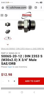

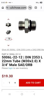

Hawkerpilot05
Dec 21, 2013
12
I know this rhread is a little old, but hope you are still around. I too have a Chinese equipment that uses the DIN 2353 fittings. I see that you can get a DIN fitting in either light or heavy with the same M30x2.0 thread. I assume either will work as long as they are both M30x2. Is this correct?
I will attach 2 pictures of the a light and heavy of the same thread/pitch. Just confused on the difference between them.
