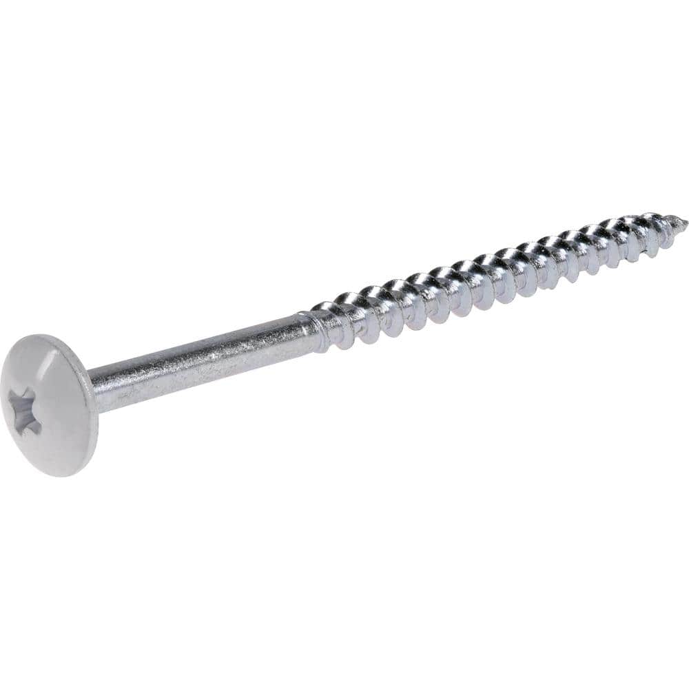

I also thought about switching to a more panhead style screw that won't pull into the wood.

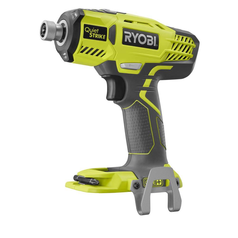

If you don't want to switch battery platforms, spend a ton of money and are not using this tool professionally - I'd suggest the Ryobi HP impact driver.
Ryobi's HP line is a step up in quality from what they typically offer. It's more expensive than their regular impact driver too, but good enough that you probably could use it professionally.
It's got 3 speeds and an "assist mode" (I think that's for sheet metal screws or some such). 2,200-inch/lbs. of torque (I'd have to go check, but I think your PC has 1400 in/lbs) and 4,000 IPM. It would be a substantial upgrade.
The problem with Porter Cable is that the parent company Stanley Black & Decker has largely abandoned it. I have a bunch of them and mostly like them, but there hasn't been a new Porter Cable 20v tool in years. There is a brushless PC impact driver you could upgrade to, but I would avoid investing more in that brand unless you scored a deal or something. The Ryobi HP I mentioned is several years newer and would definitely outperform the brushless PC.

good deal going on now if you could use some more batteries.
2 batteries and charger for $99 then pick a free tool. The Ryobi quiet strike is on the list too.

That P290 Quietstrike is selling for $79 at HomeDepot but only $39 at Amazon....hmmm.
Bah, my Porter Cable is still running fine so I think I'll stretch some more use out of it until those batteries all fail or the unit dies. I think I just need to heed the advice and make sure I finesse it at the end for the right amount of screw depth. I think I was being too neanderthal with it.

Switch back to your drill and set the clutch, the impact you have either has too little trigger control or you need to practice and get the dynamic of how it is driving in the material. Even older impact drivers could crank a 3” deck screw through 2x lumber if you crank on it.
As an alternative, you may want to consider washer head screws like GRK with your impact. They are strong and the larger head helps snug things up before they get overdriven.
