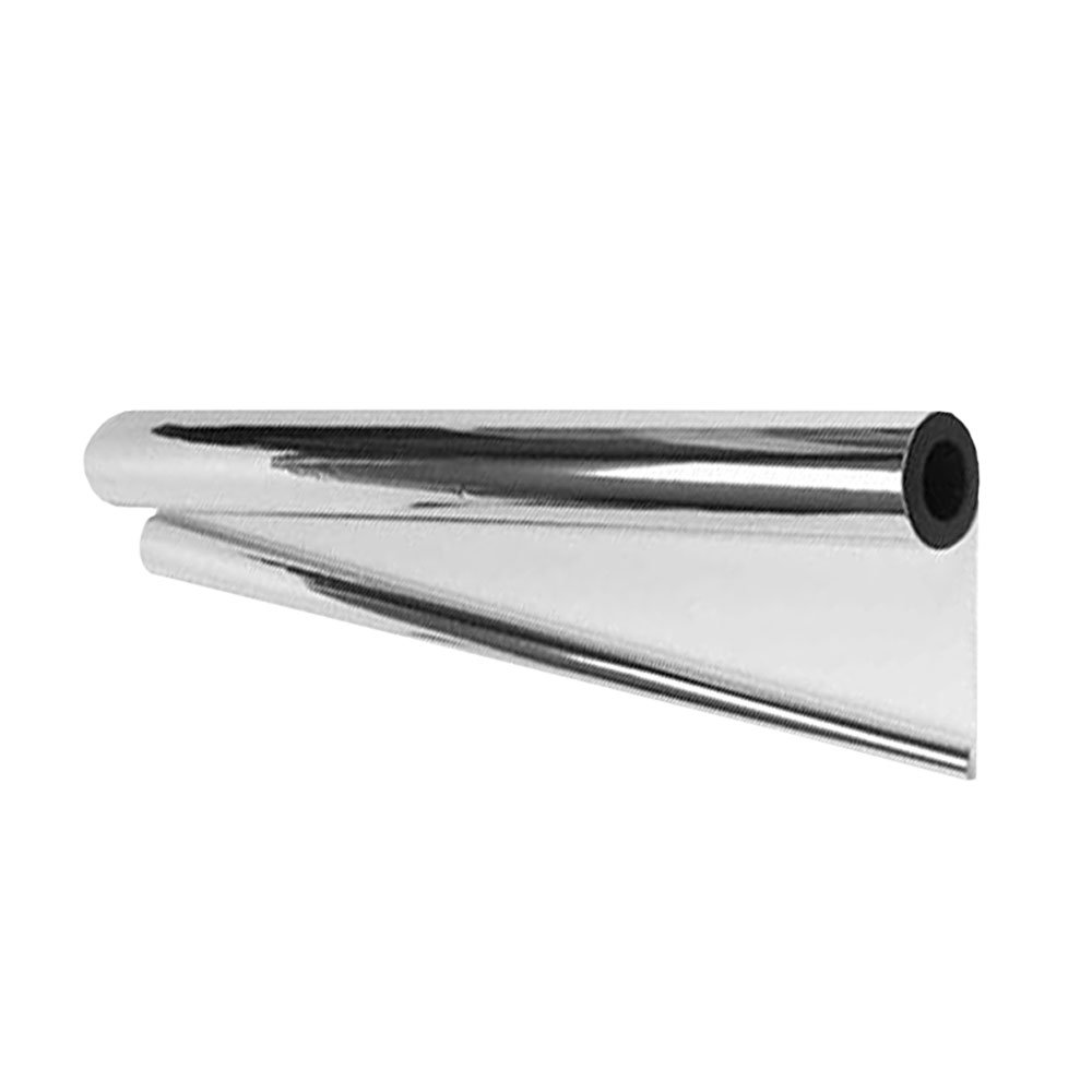

Hello all, I have begun investing some time and money into the "real" reason I bought a house, the garage. haha. Thus far I have installed the quincy compressor, air lines, and begun the fluorescent lighting installation. The fixtures I chose where the 2 bulb T8 4 ft. grey Sylvannia units that many have seen at Home Depot, however I purchased 18 of them from amazon. They are spaced about 4 ft apart and about 10ft high through the whole garage. My question to you guys is, are there any ways to improve the reflective properties the these grey fixtures. The light does not reflect very well off the grey paint, which I feel is reducing the perceived output of the fixtures. What I have tried thus far is glued mylar to the hood, however I cannot get the stuff stay flat without bubbles. However, it works amazing when it sticks. The stuff is not expensive either, came a 4ft wide roll. Does anyone know if painting the hoods white or a reflective finish works? Possible a reflective piece that can be added to the fixture, something that just screws on? Thanks again guys, this forum is great

I tried applying this mylar material, it just wouldnt lay flat without bubbling. It reflects amazing!

I can't help from personal experience, but antique car guys seem to have better luck with painting the tail light reflectors with white paint than with putting tin foil or other metallic material to help with visibility of the tail lights.

check out speciality reflectors for saltwater reef aquarium applications. it's not at all uncommon for guys with reef tanks to pump kilowatts of light into their reef tanks to produce the intensity of mid-day equatorial sunlight. it takes a lot of photons to grow stony corals.
none of the reflectors are white. the best ones are made of specular aluminum sheet. you can buy it.
another option if you just want to stick an adhesive reflective material to an existing lamp is the aluminum tape that you'll find in the HVAC aisle of your local hardware store. be sure to ground it to the chassis for fluorescents.

IMHO the only reason you need to have the reflector film smooth is cosmetic. How often do you closely inspect the reflectors above the fluorescent tubes? The wrinkles will reflect light in different directions but isn't that what you want for even lighting of your garage/shop? If you wanted to focus light you need smooth surfaces but you don't need focus in this application. You want diffusion.

I just ordered a 50' roll. Thanks again guys. This stuff should be much easier to apply than the super thin stuff I was trying to use. Thanks again
