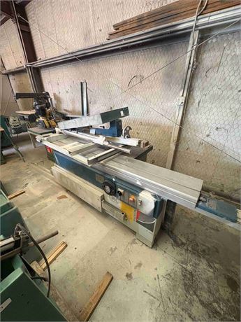

Think you will find that a slider that will rip down an 8' sheet is going to be over 20K$ and take up half that shop space. One that will do a 50" cut is about 12' long.
You can get a used 10' slider for 20% of that price (4k) or less. A older martin t71 or early t72 for 25-30% (5-6k)
Op, Sliders are nice. Used 3ph sliders are cheap, I'd recommend a 10' over shorter lengths.
You can do what you want with with a track saw, and a cabinet saw with large outfeed. Easiest to rip the plywood in half length wise with the track saw and then rip on the cabinet saw. It gives you a perfect edge to start and leaves you with a more manageable piece to start with (assuming you need 24" or a mutiple of that)
Assuming you have the space you can drop a bunk of plywood on the floor and cut it in place with the track saw (flipping a sheet up and 1" foam under each time) then walk the parts over to the cabinet saw.
A slider is still better though, and in my experience doesn't take any more room than a cabinet saw with large outfeed, and let's you do things you can't do (easily) on a cabinet saw.

A slider is very handy for breaking down sheet goods, once you use one you won't want to go back to a standard table saw. In my experience, the longer the better, I have a 10' Maksiwa. They are available new for a fairly reasonable price compared to the big name Euro machines and the quality is decent in my experience.
One big advantage on a long slider is the ability to straight line rip rough cut lumber. Also the nature of using a slider (work clamped to the sliding table) makes them much safer than a typical table saw in my opinion. You never get your hands anywhere close to the blade if you are setup properly.
A big slider will take slightly more room than your SawStop, for a second saw to do small detail work, I chose the Festool CSC SYS 50 portable table saw. It's a baby slider if you have not seen one. While not inexpensive, the dust collection is good, it takes up very little space and is perfect for detailed smaller work. Really nice for flooring or trim projects.
EDIT: I forgot to mention, the slider is excellent as a tapering setup as well. Set up some stop blocks on the sliding table and makes perfectly repeatable tapers of any reasonable length. There is also the fact that when tuned, they make perfect 90 degree cuts on material of any size. Also ripping long accurate 45 degree (or other non 90° degree) material is a breeze.
