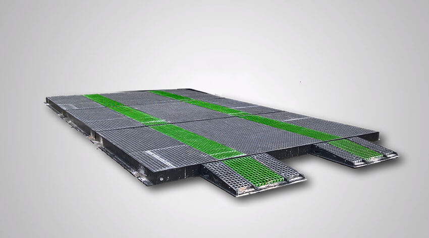

I'm looking to add an indoor wash bay to my shop... Here's my dilemma. I AM NOT going to modify floor to add drains. NOT gonna happen. So technically I need semi-permanent...
Looking for something elevated to drive ON, not a drive IN pad. So far the best thing i've found is this from MorClean... But I'm looking at 10-12k without any waste management between cost/shipping/vat...
Anybody have any other suggestions? I've been looking for a few weeks now, but figure good ol' GJ is the best place to find something!
Also, I don't really NEED waste management either, as I can just do runoff where its located.

racedeck free flow(or another brand of free flow type tile), provided your shop floor has a slope that will let the water run out.
That would be the cheapest option.

I had looked into racedeck, but I would want something that's easier to clean/maintain. Since this will be getting used daily, and in New England, underneath the decking will need to be cleaned out regularly, and would also still need some sort of box/pad to contain the water even for runoff..
I'm not necessarily looking for the cheapest option, just trying to avoid spending 5 figures if I can..

For the most part if it goes thru the Free Flow slots it will rinse away with a hosing and follow the slope of the concrete. If not a shop vac works. Had mine for 5 years and a long handled brush with a little car wash soap cleans the tiles. I wash my Mach 1 in the garage and this works fine for me. All of the winter gunk from her dd also disappears thru the tiles. Love it. CJDave.

The plastic pallets won't work for my application. I would definitely want something with a sturdier, more finished product...
I'm possibly considering something with Racedeck, but I still need some sort of bin/basin to contain the water. This is not my entire garage, but just one bay. So I don't want the water just running anywhere.

Thats the benefit of FreeFlow. The water drains through and out under the tile and not across the top. CJDave.

Yeah but the freeflow allows water to move in any direction.. including back into my shop.
I want to avoid the mats as they tear easily. You get a rock in a tire and turn the wheel even a little bit and you can tear the mat.

The underneath will get absolutely trashed if you use free form tiles. I wash maybe 5 cars a month and the underneath of mine swisstrax is disgusting. It's to be expected though, so no complaints. My plan is pull it out 2x a year for a full cleaning.
That said, Jason uses racedeck in the wash bay of one his shops without issue. They're in Chicago. Plenty of vids to comb through if you're interested.
