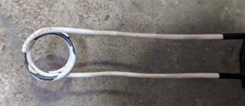

Cheapo amazon induction heater, the "coils" have like this insulation on them. It is starting to come off the one I use the most, the insulation. Is this a bad thing, if the only reason for the insulation is to keep me from burning myself, I will not worry about it, that does not work at all. So why the insulation, and should I toss this "winding".

You will have trouble if the turns short to one another. Could be some arcing at the short, not heating what you want and maybe even damaging the driver circuit. If it just touches the part you are heating in one spot it PROBABLY isn't a problem - I would expect the coil to be isolated from the input power but who knows on the cheap stuff. If not isolated it's a shock hazard. Induction heaters are slick - might have to look up what's available. Which one did you get?

Thanks for that link, it would be easy to re wrap this one that has it flaking off.....

I worked this industry as a factory service engineer. Use 3M fiberglass tape, comes in different widths, yes be aware of shorting the windings. Coils are easily made for induction heating purposes.

This is what I put on the coils I make for mine out of 10ga. wire.
I think you could probably just put it over your existing wire.

Too lazy to search for it again, but it seemed when I did somewhere someone sells small rolls of thick copper wire, insulated with the same material induction bolt heaters use.
Looked like replacements “coils” would be fairly easy to make, maybe even DIY designs for use in odd tight areas.

Supposed to used nickel plated wire with insulations like these
Bryne Mica High Temperature Wire -60~450 Degree C,Strands of Nickel plated copper wire,Insulation by Mica and Fiberglass,used in harsh environments (AWG12 10Ft) https://www.amazon.ca/dp/B07VZ9VM12/?tag=atomicindus04-20
Or
Litz wire with "appropriate" heat insulation

However, I've had a bolt buster 2 for several years. Many coils have no insulation left on the business end due to contact with glowing fasteners. I notice no issues with performance, nor issues with my tool.

You should never run the tool for more than 120 seconds at a time. You also should always "hover" the coil and try as best you can to not touch anything with it. If the fiberglass insulating wrap starts to fall apart then buy some more, cut to length, and re-wrap the copper to ensure longevity of your tool and proper function.

are the coils touching each other or do you keep an air gap between them?

I try to keep an air gap, sometimes they do touch after being wedged into an area. Nature of the beast. They still work even if multiple coils are touching. I'm sure there's an efficiency loss, I just hold the button longer. I don't use it more than 30 seconds.
The tool is typically limited by size of the workpiece, being able to input enough energy to do the job before it bleeds away into the mass of the item and its surroundings.
