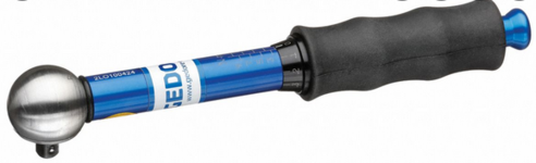

So I was just poking around a few sites because I'm debating about a 1/4" clicker torque wrench. I then come across the Gedore 762-05. I don't know if Gedore hired a designer that was rejected by Ikea, but it is an odd looking duck to me - and the price runs about $500ish. Anyone know why the head design is so weird?

It looks like the OP's torque wrench was designed by the same person who designed the costumes for "Spaceballs".
I came across it while searching. There's no way I would pay that much for a 1/4" torque wrench - or any size torque wrench for that matter. I'm too much of a tight@ss. Plus it just looks weird as sh**. I don't even see how one would switch the ratcheting direction - unless it's one of those that's only meant to work in one direction.

This wrench with a padded handle and rounded head, might have merit in a world of repetitive stress injury and tight assembly areas. :dunno:

Looks to me like a good choice for exposed carbon fiber projects where one stupid nick could cause a world of grief. Other then that, ya it’s ugly

First, its a slipper torque wrench wich makes it impossible to overtorque.
Second its for industrial use all day long w/o the need to be recalibrated every 500-1000 clicks.
The round head, makes it harder to damage paint and other stuff on the assembly line with it.
