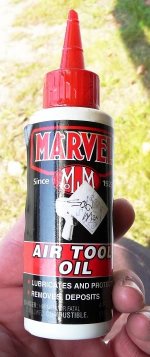

Air tool MMO comes in small dispensing bottles like the one shown and also with regular MMO in the "Flip Spout" version.
For Canadians around here, I got my MMO in those bottles at Steel City Surplus in Hamilton.
