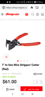

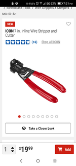

Does anyone own and use these inline wire strippers?
I noticed the Icon version awhile back and went to look at them in store. I've also handled the Snap On version on the truck. Both are USA and I'm assuming made by the same manufacturer.
Electrical tools are generally low torque and not built for heavy duty use. But I noticed both versions felt cheap. They felt like something you find at the dollar store.
I'm curious if this is just my initial opinion and they're actually a solid and useful pair of pliers. Or if the hand feel accurately identifies them as junk.

My cowowrker bought the Icons last week. He hated them, said they wouldn't strip 16ga wire which is what we mostly use, said he was gonna return em. I didn't try his to test for myself, only briefly handled them. The style didn't apeal to me at all.
KnurledNut
Jan 28, 2011
8,194
n/a
Snap-on makes two versions:
The PWCHHD7 is the version pictured in @AJHD original post. It has 4 stripping holes and covers 6, 8, 10, 12 awg. or 4.1, 3.3, 2.6, 2.0 mm. I assume the HD in the part number stands for heavy-duty.
The PWCH7 has 6 stripping holes and covers 10-20 awg. I just now noticed in the specifications that they state these are solid wire sizes. If thats true, they should also be able to strip 12-22 awg. stranded.
If Icon had copied the PWCH7 instead, it would likely be a better seller with more demand. Offering both models like Snap-on does, would be the icing on the cake.

I just handled the icons in HF. You're right about the feel but I attribute that almost entirely to the grip. It's not the textured grip like most icon pliers. It's more like a slip on type grip but there's actually foam underneath it, so it has a weird give to it that you'd wouldnt expect from a typical plastidipped handle. It's also super slippery. Otherwise they seem fine.
