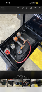

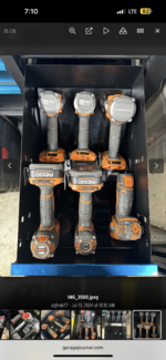

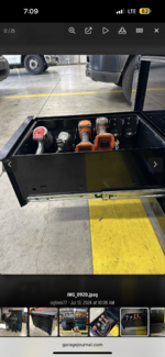

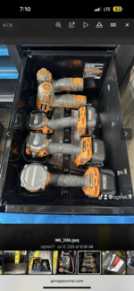

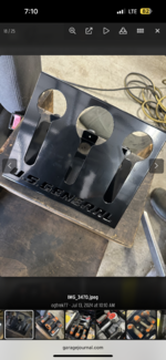

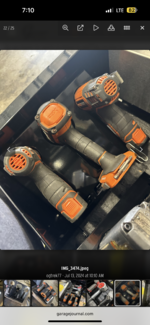

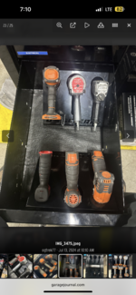

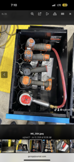

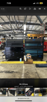

I bought a SnapOn Classic 54 DoubleBank(Work) after CoWorker bought SnapOn Master 72 TripleBank
& I so wanted that PowerToolHolder
LORD bless me to find FaceBook guy selling his from SnapOn Classic 72 TripleBank (at my price) only issue was gonna be size/Height
Well came too tall for SnapOn Classic 54 DoubleBank(Work)
Too Deep for MacTool Edge 54 DoubleBank(Home)
Got CoWorker to cut just shy of 2” off Bottom for SnapOn(Work)
But couldn’t use bar because it push battery too high to close drawer so it look like yours in the pic
This yr I bought US General version from Harbor Freight for Mac box(Home)
Cut 1” off bottom fit perfectly
It has multiple screw holes for the bar height to be adjusted
So go back to work & bend & selfTap screw in SnapOn holder voila done!

& this is the magnet version
