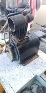

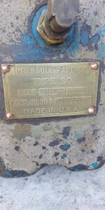

jayshoppa
Oct 3, 2024
2
Hi guys this is my first post, please advise if it should be a new thread etc.
Based on the knowledge evident here I thought I'd post about this old IR i'm working on . . .
So it's a simple (old) ((heavy duty)) 5" bore single stage I'm really looking forward to running-
Problems have been a complete failure to identify it enough to find some data about rpm, hp, cfm, and also to even begin to check for any parts availability. Image search hasn't even turned up anything similar.
Based on other compressors I might guess to try a good 5hp motor and 700rpm to start, and I guess to shoot for about 130psi.
Overall condition is great and tight, and until I have more info I will just give cylinder a light hone and fab a new felt crank seal.
____________
To the point TLDR
This pump came with a type of head unloader valve that appears in good operational condition but was disconnected.
It seems like when the unloader piston is pushed down to overcome the spring between it and the valve, it seats a 'hat' ontop the intake valve, effectively closing the valve intake.
From what I read that is opposite quincy and wabco type unloaders that hold intake valve(s) open?
It would seem the suction created wouldn't be as effective at unloading for continuous as just opening the intake valve. Was this ever a "thing" ?
The pump also didn't come with a diaphram/valve for load/unload adjustment but I assume I can add any of those in that can adjust for single stage pressures.
Any input is greatly appreciated!
Since I've found nothing on this machine, am uploading a few vids of it torn down and valve/piston/crank internals etc.

jayshoppa
Oct 3, 2024
2
To follow up Ken @ Airflo found a manual for it straight away!
The model is simply '5' or '5E' for electric. 1938. There isn't any guidelines on HP or rpm but that's ok.
It is the precursor to more well known 2 stage 'model 41' that was equipped on the rear of 1942 Cletrac M1 crawlers (air force).
About unloaders, the parts diagram confirms this is the original SV unloader, all parts are accounted for (Only 2 springs, hat, and piston), and the design actually does unload by closing air intake of SV (opposite all others I'm aware of).
Looking forward to getting to testing.
Will post up over in 'vintage compressors' then!
/edit - oh and it weighs 220lb dry . . . has 22k1 disc valves
