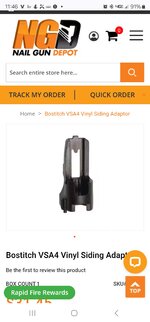

I know nothing about installing vinyl. But installing zip, I know there are attachments for nail guns that prevent the over-driving of nails..

I can say that if I had known there were adapters to allow the nails to sit proud so you can use nail guns, I would have gone straight out and bought a nail gun and adapter without question. I was just the unskilled monkey trying not to get in the way of the guy who actually knew what he was doing, but he told me we couldn't use nail guns because you couldn't consistently control the depth.
Even on walls in good shape, there's enough variation in the material that adjusting the nail gun still won't give you consistent results.

I don't know about vinyl, but the steel siding I installed on my house 25 years ago was done with a Senco staple gun with a siding spacer adapter on the tip. It was easy to place the staples in the right spot and depth.
Maybe staples don't meet code on vinyl or maybe things have changed since, but they are what the supplier said to use, they were way fast and I've never had siding issues other than some unrelated peeling paint on the south wall.
