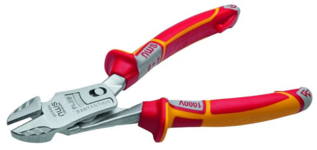

High quality and not from a common name on insulated tools? That you want to trust your life to? Do you want cheap ****?
Other than what's listed by Olli, NWS. But none of these are going to be cheap. I'm sure Amazon has some great bargains on unknown brands though.

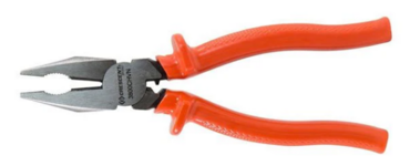

I really like the Bahco Ergo slim drivers. This particular one is a Pozi/slotted combo:
I’m not super crazy about the new Klein options, but the older stuff was superb.
Stanley makes some nice interchangeable insulated kits. This one has a standard handle and a precision style handle, with an optimal selection of blades. Great for portable grab and go use. This is made in Taiwan.
