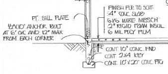

This post isn’t directly garage related but the project contains garage space. I am adding 800 sq-ft onto my home in Connecticut. The addition will be slab on grade with radiate floor heat. My plan is to insulate underneath and on the sides of the floor with 2” foam insulation. In the living space I don’t want the foundation walls to be higher than the floor (like in the garage). The foundation wall is 10” thick and the regular wall is ~6”. If the floor is poured even with the top of the foundation, how do I insulate the sides? Will the floor settle slightly, leaving an uneven floor around the perimeter?

Can you do a sketch? IF a slab on grade, why the foundation walls??
If the subgrade is prepared properly, it should not settle, or should all settle together.

Here is a sketch from the architect. The insulation in the sketch isn't on the sides of the slab like it should be.
The foundation is needed to be bellow the 44" frost line.

+1 that the floor should not move. As long as you have a proper compacted base and aren't putting it to an industrial use, it won't go anywhere.
The only thing that could move it is heaving. (From freeze/thaw cycles.) So... in your situation it will be important to keep the floor heated. (Even if you aren't using the space and want to save some money, you'll want to keep the floor heated when it's below freezing outside.) Heat will eventually soak through your insulation and heat the pocket of soil between your foundation walls under the slab, which extend to your frost line - so you shouldn't get any heaving. (That insulation on the inside of your foundation walls is critical, also.)

Thank you all, very insightful information. nmk61802, in that picture you sent the insulation on the sides doesn't extend below the frost line. Is that okay?

Personally, I would not get get hung up on getting insulation below the frost line. As mentioned above, insulation just slows down temperature equalization. If cold enough eventually the temp will hit equilibrium. On my garage (forced air heat) I used 24" sheets to insulate the foundation as it was the most economical use of materials, which left me approx. 6" short of the 30" frost depth in my area.

You definitely want to insulate the vertical face of the frost wall to prevent frost from penetrating through the wall and freezing the soil under your slab.
To insulate the edge of the slab you could form a slab shelf in the top of wall i.e. step the wall in at the top. This will allow for insulation to be installed under the wall framing, which would cantilever out over it. This is a fairly typical detail that your concrete guy should be familiar with.
