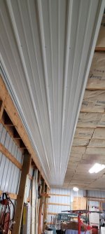

I'm using the interior steel mentioned a few posts up. R38 batts. Slow going, but so far happy with the results.
