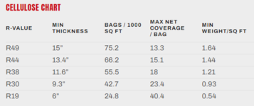

Cellulose is a whole 0.8 lbs more a square foot at R38 than fiberglass.
Still well within the 5#

That increased weight matters more and more as you increase the desired R-value. It may not matter if you only want R-38 in your attic. 29ga R-panel/liner panel supported at 48" actually sags a tiny bit with 18"-20" of blown fiberglass on top (~R-55), which is less than the weight of cellulose at just R-30.
But if blown fiberglass losses 50% of its r value in high temp differential situations R30 cellulose is going to perform better than R55 blown fiberglass and be a hell of a lot cheaper to boot.
