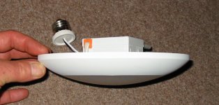

Thanks guys -
I went with a LED retro-fit kit as DByers suggested.
OK,
So I am getting closer to this project.
Yesterday I went to Lowe's and bought Sylvania LED retrofit kits ($34.99 each). The led box is slim and will protrude less than 1" into the ceiling. the new fixture is solid aluminium so no air can vent. Wish there was some sort of gasket on the back though where it will touch the blueboard/plaster.
So my plan is to remove the cans internally, stuff some insulation in the cavity (allowing for air circulation) re-install the can portion, then mount these. The 5" can will keep the insulation off the back of the new LED fixture and Edison socket, and LED does not generate much heat so I think it is a good plan!
Any thoughts?
The staging is set up, and I pulled a bulb today, next week I'll do the install.
I'm posting pics so anyone else in this dilemma might find them if they search.
Best Regards,
Mustang51js
Jan 24, 2014
1,734
Haskell nj
What you needed to get was air tight trims, but those that you got will help. Your still going to have some heat and may melt the snow since the light is only a couple inches away from the roof,most of the heat was prob the air inside just going up. They sell the recessed trims in led also if you want it to look more like a recessed light.
