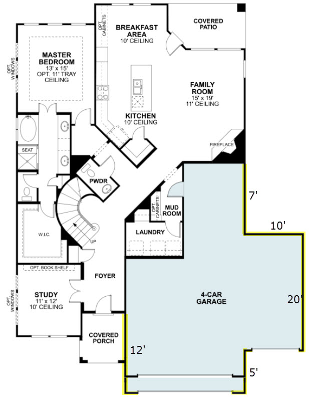

I'm building a house and want to know if insulating a garage is worth $1890.
I requested a non-standard option to insulate my garage, because it isn't normally insulated. It's a 4 car garage, so the perimeter is quite long.
The house is a decent one, so it will have good insulation already. I went into another house that was being built in the same neighborhood, and the garage was actually pretty cool already considering it was 90 degress outside. Also, without the AC on, the temperature in the garage was very similar to inside the house.
I plan to install a mini split, but $1890 seems a bit steep.
I think I may go to the in-progress house again and get an ambient temp rating without AC to get an idea.
Thoughts?

For your consideration. The measurements are rough estimates.
Above the garage is a media room, so it's insulated.
No doors or windows were open when I was in the house.

Many thanks for your feedback guys. Sounds like a resounding yes.
The only reason I was hesitating was because it already was fairly cool (compared to my current 100 degree oven garage), but considering that I'm buying this house because I can get a 4 car, I'll insulate. :)

It appears you have about 60' of exterior wall less the garage door openings. Assuming they are 10' high that is 600 sq ft of material. Add in some for above the garage doors and lets say its 700 sq ft. total.
R-21 insulation for a 2x6 wall is .67 sq ft. = $469.00
R-11 insulation for a 2x4 wall is .19 sq ft. = $133.00
You do the math...I'd be buying it myself and installing it myself...
Look at it this way...your paying yourself 2.00 per sq ft. to install it.
going rate on a residential project is about .10 sq ft.
Thanks for saving me time by doing the calculations. Been in meetings all day.
I didn't expect the insulation to be that cheap. I'll try to get some better pricing.
As for doing it myself, I'd love to, but I'd have to sneak in, and take the risk of them ripping everything out. They're pretty adamant about doing anything to put themselves at risk.
