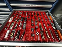

I have an entire Lista drawer full of various taps. Each time I need a specific size I tend to purchase the correct tap if I don’t have it for that application. I really need to order a set of the spiral flute bottom taps. I have been having really good luck with the YG-1 brand. They are exceptional quality for the price.
