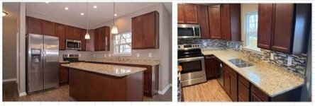

Here is a before and after. I left the trim as is.

Ah sorry the “collage” really shrunk it down

What’s this about eighteen windows? Thought you were just trying to make a nice way for the tile to happen at the window opening there. You don’t HAVE to do that to your whole house, unless you’re gonna tile every room or something. Won’t necessarily look good. You wouldn’t have all your cabinets and countertops in your house match, would you? Tiling a kitchen’s satisfying. Have fun working it out!
R
Ryanbabz71
Jan 24, 2016
492
If I was going to trim out this window (I did not) I would have to have them all match then that’s where the other 18 came into play. I’m done with the kitchen tile, now on to the bathrooms [emoji16]
