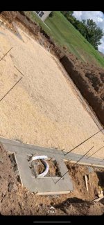

Well, after many delays I finally have a print. It is not finalized, but its something!! Still waiting on lawyers to close on the lot (since February) but we have started selecting some of the finishes (siding, roofing, doors, trim). The house will be flipped 180 from this layout, kitchen layout is incorrect, and we will be flipping the main bath so the door does not line up with the front door.
The lumberyard was trying to sell us on "Viwintech" windows. Has anyone had any experiences with them? There are so many windows these days its hard to know what is good and what isn't.

I'm not sure what the current cost per yard is, but I know concrete prices have been pretty wonky the last few years, at least around here (DSM). I need to have my rear patio and front driveway replaced and keep hoping for a little slump in the market, which hasn't happened. I'm just about ready to say "forget it" and have it done.
I really like that garage layout! Seems like a very practical yet comfortable amount of space.

Thanks! I plan to have a 2 post hoist in the tandem area with cabinets on the house side. I have a 1979 f250 I plan to restore with my son, and wanted to be able to keep the "work area" separate from the daily driver area. I haven't had much time to mess with the layout yet. still trying to figure out lift spacing from front wall if I want to have the cabinets there or not. don't want to be too cramped when a vehicles on there.
On the concrete note. I had my driveway done at the current house, it was very long and it was 10k. I have heard that the new I-74 bridge from IA-IL is using tons of concrete so that could play into the prices also. IDK how much truth to that there is.

Now the city is balking at the garage size, and states it should be no more than 40% of house size, putting us at around 750 sq ft. I currently live in a smaller house and my garage is larger than that. Trying to work around this. The builder says he can wall a section off for "storage" and then remove after final inspection. hopefully we can work this out soon :dunno:

Glad to see they started! The wet spring has everyone way behind schedule.

Looking good there, but I cant believe the 52K price tag for the foundation.
https://www.replacement-windows.com/windowbb/ is a great place to research windows. But I imagine you already picked brand by now.
The 52k was everything including the flatwork for the basement, garage, driveway, and sidewalks. But still nuts how much it cost!!
