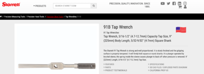

Irwin *****. I need a high quality tap holder
Bubba Fett
Jun 11, 2018
1,520
Eastern NC
Here is my Irwin.
Contact Irwin. Even if you plan on getting another set, they should replace this, and they need to see these pictures. They need to know that they (or more likely their suppliers) are selling a defective and potentially dangerous product.
Without feedback companies just assume everything is hunky-dory.
shawhite
May 28, 2014
1,519
I sent it to Irwin and they replaced it. New one came in a box Made in China on the side. That is when I replaced it with a starrett.

Here is my Irwin.
-Not to knock the OP but those photos are a textbook example of what happens when you stress something made from zinc die-cast, also sometimes called "pot metal". Zinc die-cast works just fine for carburetor or transmission bodies but is absolute sh*t for any sort of structural integrity on a tool like this.
:oops:that's some porous looking metal, looks like a sponge. How they got the finish to be so smooth and polished when the inside looks like that is quite an accomplishment.
-Yes it is porous, that's part of the telltale sign of a cast metal. Zinc alloys are brought to a molten state, then pushed under high pressure into the mold. Zinc die-casting is unparalleled in high production for producing a near net-shape that holds detail and thin sections while being relatively low cost to manufacture. The smooth surfaces that appear to be polished are a result of the mold surfaces being polished, the molten zinc alloy mimics those mold surfaces. While ideal for high production components, zinc alloys are a poor material for most anything subjected to stress. Manufacturers of cheap tools will use zinc alloys because it's cheaper than steel and estimate that most buyers of cheap tools won't know until after the purchase.
Learn to recognize when something is likely made from this material. If it appears to be beefy and has a dull, silvery (can also be painted to disguise it) finish it's likely a zinc alloy. If you can gouge it with a house key it's zinc die-cast. If you can see a parting line, result from the two mold halves, and it's inexpensive it's a zinc alloy. The easiest way to identify it is if it's non-magnetic, unless it's SS or one of the red metals. Plain low carbon steel is just fine for a tap/die holder, I've made a few and they hold up under industrial use in the shop.
Cheap tools made from the zinc alloys will self destruct, don't buy any more of these.

Sterrett if you got the cash
Union Butterfield's are very nice as well

ebay. used. greenfield, COLUMBIA (I love mine), starrett.
I have a few of the sliding T-handle style by Greenfield; they're 40+ years old, so they should be the "good stuff". But I absolutely hate them; they loosen their grip on the tap during use, and when you unthread the tap, the tap then falls out of it. I don't know if all Greenfields do this, but the ones I have do; they use a different, less complex and cheaper, clamping design than Starrett. Because of this, I bought new Starretts; they have the best clamping design and do not lose their grip on the tap, which is why they're worth the crazy price IMO. Maybe Columbia uses a similar clamping design like Starrett, but the Greenfields I have don't.

My enco one does that. My starrett does not. The only difference really is the starrett has the jaws as part of the body where the enco has a pair of jaws held together but pushed apart with a spring and the threaded sleeve you tighten it with holds it all contained. Of my smaller "regular" tap handles, my starrett is the only one that doesn't loosen also. The bigger ones that are two halves where the handles both screw inward to grip the tap don't loosen either, but are of a different style.
Steve_P
Sep 15, 2010
5,245
I think you have the descriptions opposite. Starrett has two independent jaws, that you can remove, connected by a U-shaped spring. The cheap ones use a male part, connected to the handle, with a split external conical design, and the internal portion of this holds the tap; the part you tighten with your hand is a female internally tapered conical sleeve that tightens onto the male to squeeze the tap. This just doesn't work well IME.
